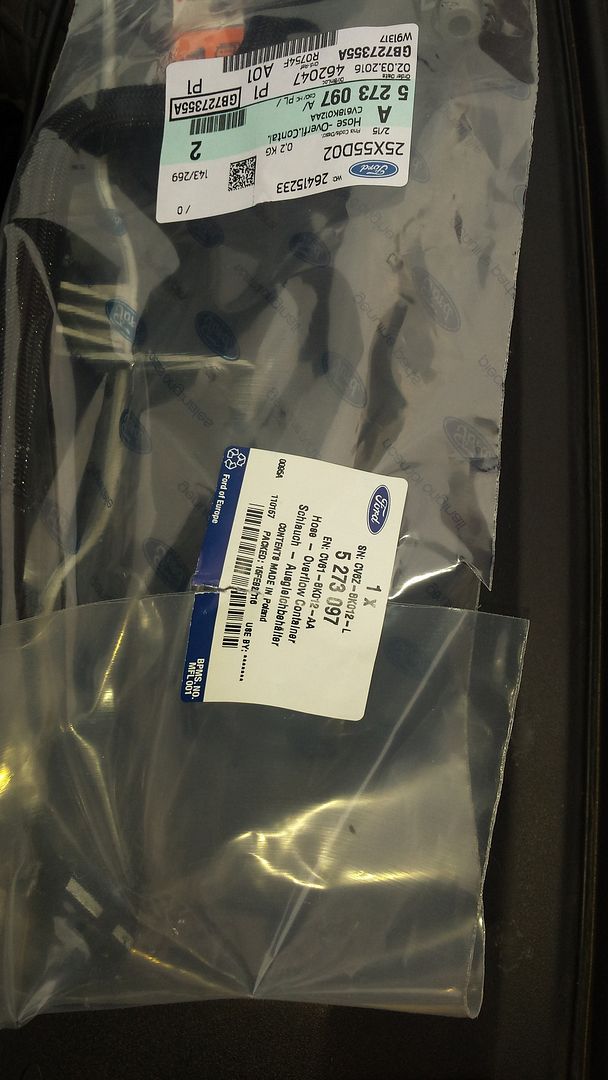

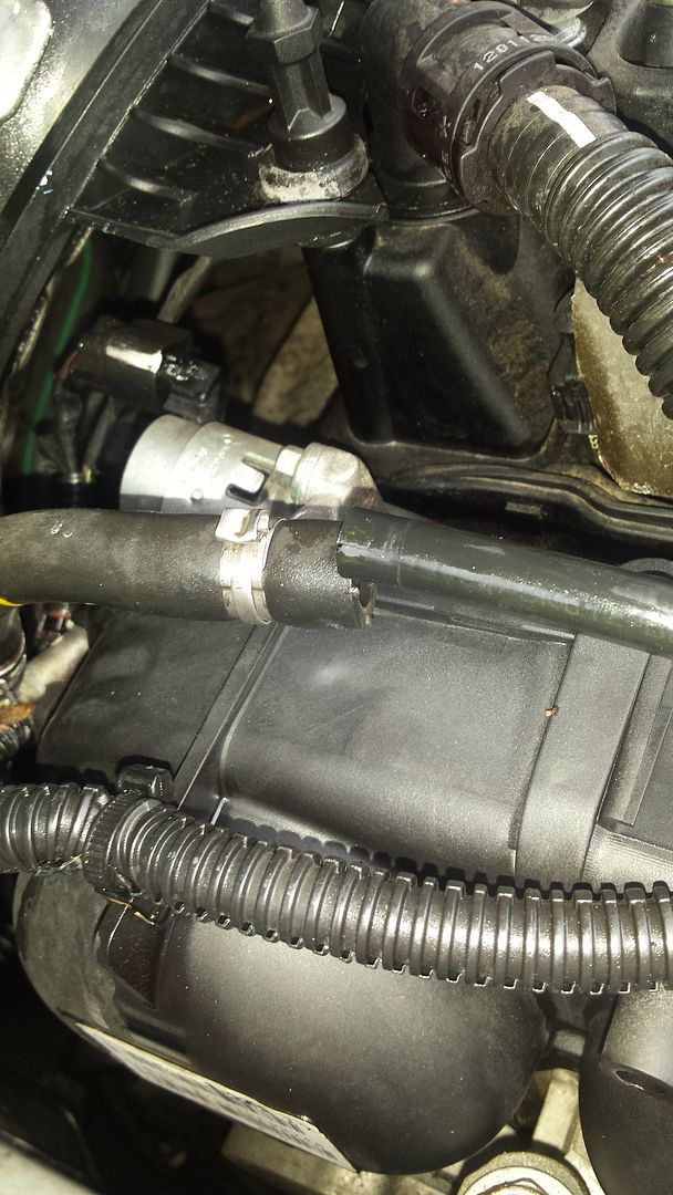

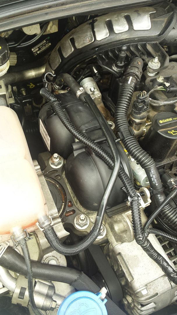

For those that aren't on Facebook I came across an issue with a coolant hose. The hose fits into the top of the expansion bottle. Its made from plastic and became hard and brittle only noticed issue when I was loosing coolant slowly like 500ml over a 2 month period. As it was going for a service I asked them to find out where the leak was. My wife took the car in service was completed, they had located the leak and the part was going to take 5 days to arrive. The wife drove home just round the corner from the house steam everywhere. So I contacted garage to find out which pipe, asked them for the part number. I then rang another dealership I was told we will have it for you latter this afternoon. 15.00 and the part is on the shelf I fitted it in under five minutes. So if anyone has the same pipe as mine I suggest you get it changed I will attach pictures of original pipe and new part number. The new pipe is all rubber no plastic

I cannot believe how near we were at the weekend to an engine failure on this very same issue. As luck would have it we were putting a parking ticket on the dash of our car when we heard a whoosh/pop noise. Looked under the car and noticed coolant dripping from the under tray. It was the exact problem that the OP had.
( Another 10 seconds and we would have put the ticket in the window,locked the car and gone shopping only to come back oblivious to the fact our car was about to overheat and possibly seize without us knowing due to a major coolant leak.)
The old design of pipe is just ridiculous,a brittle plastic section coupled with a rubber piece. It was always going to fail at the connection!
As mentioned the new  part is now all made of rubber with a solid clamp at the coolant tank end, and is easily fitted in under 5 minutes. I do however believe that Ford should be recalling all owners with this old crappy design of overflow hose fitted to there cars and replace FOC before there is a wave of claims for engine/turbo failures.
Like the OP we have a 1.6 Ecoboost, ( in150 BHP guise ) engine in our Mk3 so am not sure if it affects all petrol models or even some diesels, but please check yours out before it's too late.
