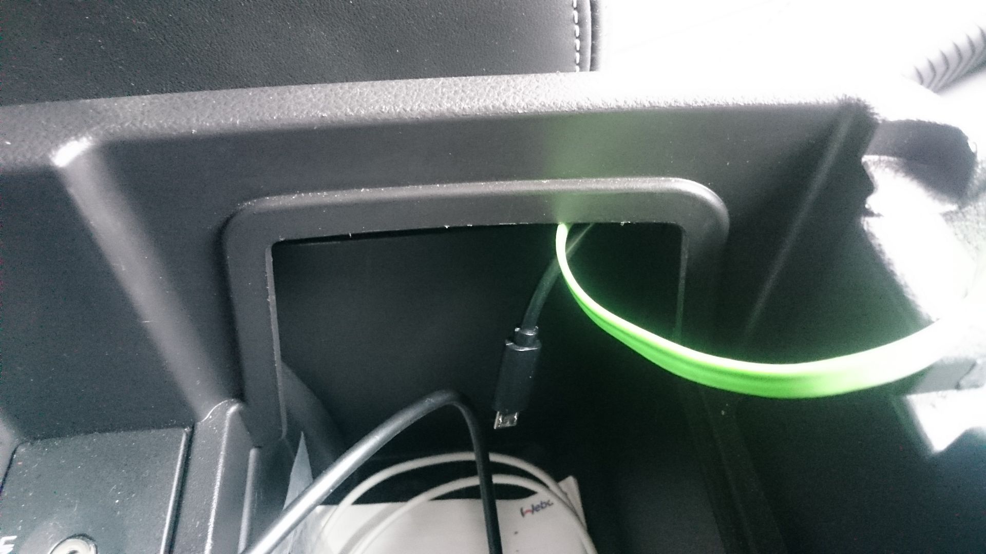

i have a couple of these under the centre console
https://www.ebay.co....aVyJm:rk:8:pf:0
spliced into the 12v power plug wiring using scotch locks, then the usb cable(s) can be fed under the arm rest it is quite tricky but there are gaps on either side under the arm rest that the cables can get through best using the passenger side gap so as not to get in the way of the handbrake
